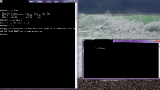

still no. the sd formatter says the card is write protected... but i did not protect it in any ways...
and i also tried formatting via cmd(diskpart->list device-> clean) and all i get is an IO device error...

This is a uSD card we are talking about correct?
Sounds like it may have hit it's end of life read/writes.
Some early SD cards failed way before their normal lifecycle.
