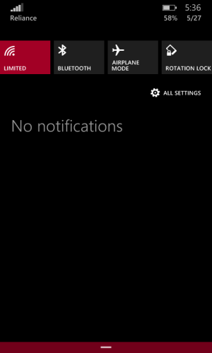

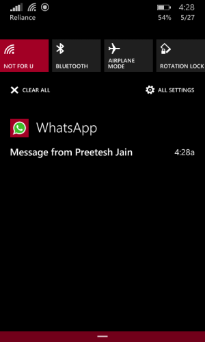

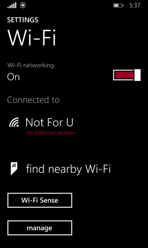

Hey Guys,
I am facing problem connecting to the wifi. I started facing this problem when I updated my lumia 520 to windows 8.1 Preview for developers and after that whenever I connect to the wifi, it shows LIMITED on the wifi icon. First it gets connected easily and after sometime it shows this error. I have never faced this type of error before.
Please help :sweaty: :sweaty:
I have attached the screenshots below.
Thank you

I personally believe the Limited notification is new in Windows Phone 8.1, so it could be that its complaining more. Not likely though.
Typical troubleshooting methods would be a soft reset (press and hold power + volume down until the phone vibrates) on the phone's end and you also may want to reboot the wireless router to try to clear up issues it might have.
I usually get that error when there's been a power cut. Easily fixed by turning off and on WiFi on the phone after the modem has re-established net connectivity.

I also got this error even when my internet is working properly.
I usually turn off wifi and turn it back on this solve the issue.
With the upcoming updates it will get improve.
Both Preview for developers phone and normal update shows wifi limited error. the only solution to work is to reset to default setting your wifi and restart your phone. works easy without hard reset and soft reset.
