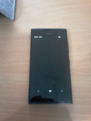

you can see what is happening when i updated. call is revceiving, but i can not perform
A specific case if Settings, call are accessible. Then,

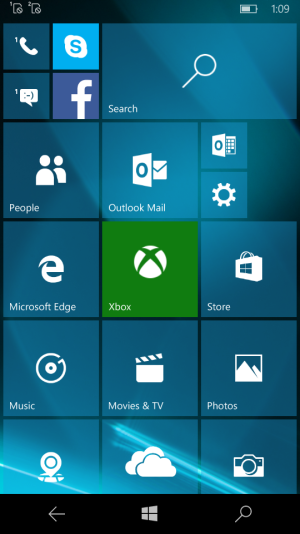

wp_ss_20150903_0001[1].pnghey I got my start after a button hard reset :) try it I think it will solve the problem..good luck guys...after this I had a nice start screen with colorful background..pic is attached.. :):winktongue::asleep::winktongue::winktongue::winktongue::winktongue::winktongue:
