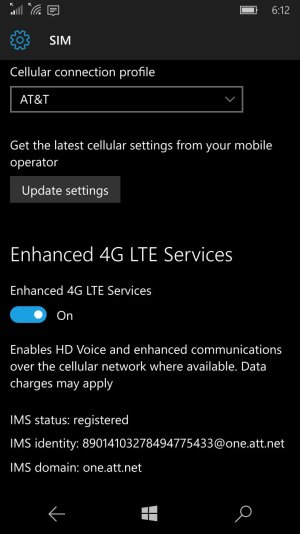

I don't know if the 950XL supports this feature. I have an AT&T branded 950. When my phone got the prompt that the SIM Settings had changed, I noticed that I had lost HD voice. I noticed this when my son called me (he's on AT&T with an IPhone 6s) and I could tell that the HD calling was not on as HD versus normal calling is a very distinct difference. So, I checked the settings and noticed that it was gone from my phone. I got to thinking about what had changed since this feature had been working and remembered that I had gotten that message about SIM settings. So, I removed the SIM, rebooted the phone, powered down and reinserted the SIM to see if that would force the settings to update. It did, and the setting reappeared and HD calling is working again. I've not had this problem since. Hope this helps.
Thanks!!! I can confirm that this worked on my AT&T 950. The steps I took were slightly different, although not much. I shut the phone off, pulled out the SIM, and turned the phone back on letting it boot all the way. Then I shut it off again. Re-inserted the SIM and turned it back on. I went to the SIM Settings and I was immediately prompted with the message "Restart Required. Your Phone's settings or the SIM card have changed. Restart your phone to complete the installation." At this time, the HD Voice setting was still not there. However, after rebooting again as the message suggested, I checked the SIM Settings and the option was available (and also enabled automatically). Thanks so much for your help VineRider.

Yes, Settings>System>Phone - Scroll down to Cellular & SIM and select this - on the next screen select SIM settings and then scroll down to Enhanced 4G LTE Services. You should see a slider to turn this on or off. If you do not see the slider or the Enhanced 4G LTE Services, then your SIM settings are causing this.

Update: I followed the instructions on removing the SIM, etc., and now the Enhanced 4G LTE Services has returned. Thanks! (I also re-learned how to correctly remove the SIM card, by pushing it in to extract it out!)

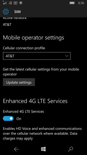

Dam, I tried this method, and was not able to get this Enhanced 4G LTE Services setting on my AT&T branded 950...did the procedure twice...then I wondered...lol:
AT&T HD Voice coverage area
View the map of AT&T HD Voice coverage.
And dam it, my geographical region still does not have HD Voice coverage....Reno, NV...dam:(
But thanks for this information...!
~~~~~~~~~~~~~EDIT~~~~~~~~~~~
Hmm after more closely examining the AT&T HD Voice Coverage areas within the US.....Reno, and Carson City are indeed covered....still not getting the Enhanced 4G LTE Services settings:
It only lists:
  • SIM Info
  • Cellular Network
  • Mobile Operator Settings
  • Internet APN
  • MMS APN
Have removed the SIM two times, rebooted, prompted to restart....no success...:(
Finally as I was going to a AT&T Corp store for a new SIM...even though I was on 10586.107 via Preview Release Ring...no matter what/how many times I performed the above trick...no success..so utilized MSRT, and flash, then upgraded to recently released 10586.107 from AT& T servers...complete install...
Success!
Definitely a bug...now AT&T... the more recent firmware upgrades...please!
