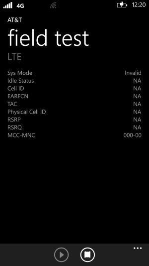

Do you get LTE on the 1520 if you swap your wife's SIM with yours?
Here's the LTE field in the Test menu(##3282#).

Okay, finally got LTE working. AskStraightTalk on Twitter got me fixed. Problem? Not sure and neither are they. As a last ditch effort, they reset my account and a few minutes later I had LTE. So, now I have a beautiful Lumia 1520, working perfectly on ST.

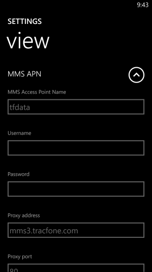

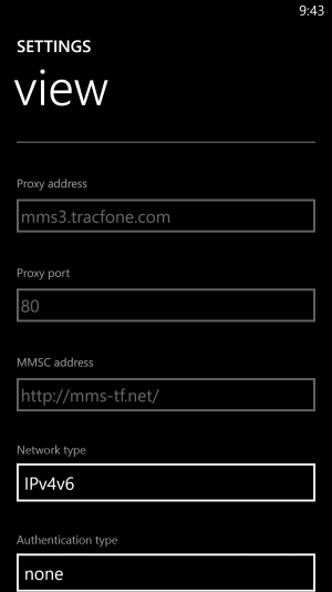

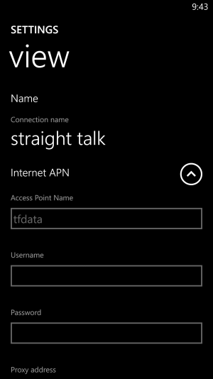

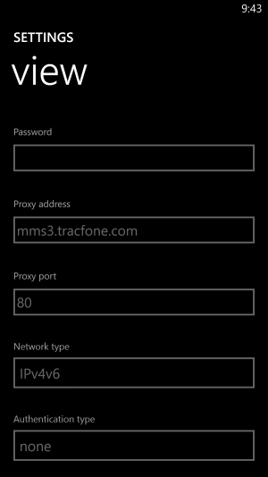

No, I haven't had any issues with notifications, push, or live tile updates. Actually, I've noticed a marked improvement, over my previous Lumia 928 on Verizon.
Sent from my Nokia Lumia 1520 using Tapatalk
Really appreciate your help. Can't thank you enough. I have the exact same settings. I tried it through both cellular and the APN settings app, didn't make any difference. Did you do any changes in the field test? I am starting to think this issue is from straight talk, but you know how their support is. Thanks for your help.
Access Point settings override Cellular settings, afaik. The only changes I made in the field test config, changing the polling time from 3ms to 1ms. I don't think this will effect your issue, though. I will likely change it back because I am noticing, about, an hour and a half shorter battery life.
On your email and app notifications, what do you have the sync settings at? I have my email set to push. Most apps will be delayed, unless they are Microsoft or Nokia official apps.
