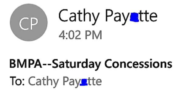

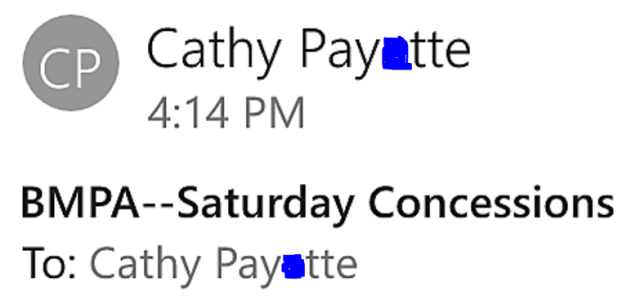

First image of each set is zoomed in onto an email on 10536, the second on 10549. Any rounded letters are very jagged and straight letters are inconsistent in thickness. The display looks "broken" when you take a closer look. Dots are not round on closer look. My first thought was that something messed up the hardware. I did a hard reset and still had the same problem. I rolled back to 8.1 Update 2 and the problem disappeared. Maybe just a single update hiccup? Has anybody else noticed this?
10536
10549
10536
e.g. look at the thickness of the letter t in the last name of the second one, bottom.

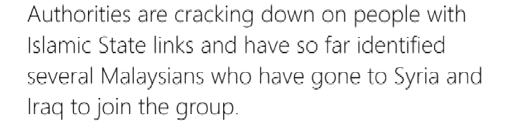

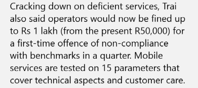

Font rendering had always been a problem on 8.1 Update 2 also (I am currently on that).
I can totally agree with you on what you pointed out.
A closer look and it looks like the phone's resolution is total crap. But that is only with text, it's perfectly fine in images.
But not all text-only rendering is bad.
Eg:
Reading mode on IE (TEXT ONLY)
The font rendering done here is good (acceptable).
Tapatalk renders also good. ^^^

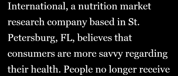

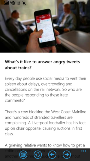

But when it comes to text-only on MSN and Paperboy app
MSN app
Paper Boy app

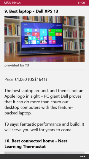

These same apps while showing an article with embedded picture, do the font rendering smoothly (with minor but acceptable flaws).
MSN
Paper Boy
I don't know what conclusion to draw from these results.
Whether its the app problem or the low pixel density making these things happen.
10536
10549
10536
10549View attachment 114463
MSN app
Paper Boy app
MSN
Paper Boy
