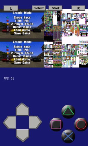

Gran Turismo- Works at about 30 FPS, though loading from a saved state, causes it to show the game twice. (Pictured below)

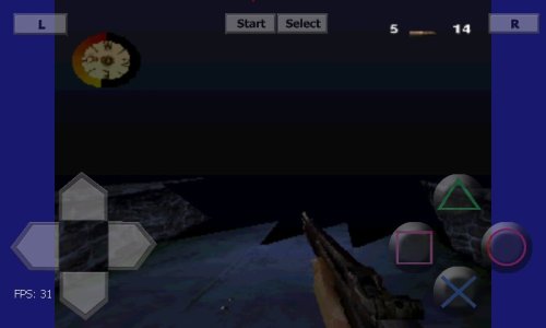

Medal of Honor- Works partially running at 20 FPS with audio, loading saved states worked, though in the first level the map isn't completely loaded and gets cut off. (Pictured below)

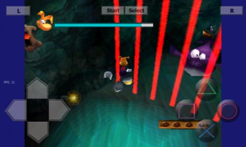

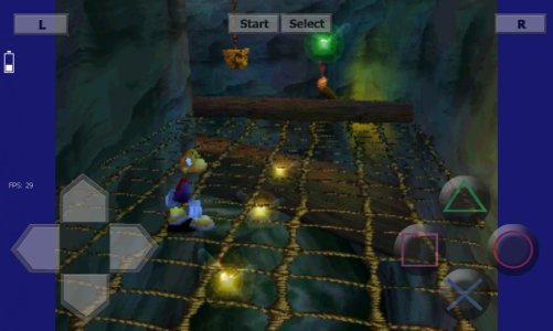

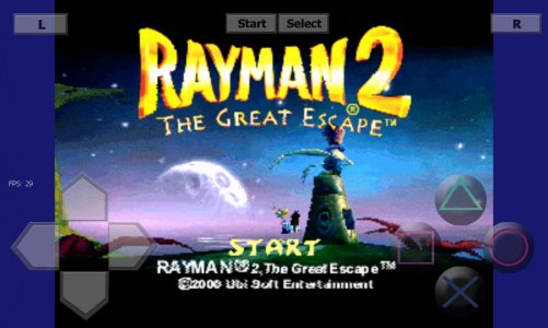

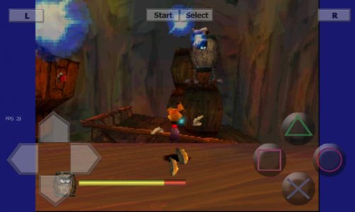

So rayman 2 playes great on my 920, most of the cutscenes hang but the music is good and the controls play alot better then I expected! (fps is smooth alround)
heres some screenshots:
