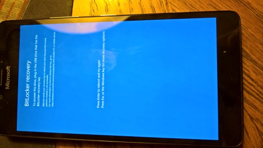

Blue Screen: BitLocker Recovery Key?
Mark F24
Oct 12, 2014
410
Visit site
I see a couple of posts recently with this, I tried to enroll in Insider from 14393.221 and this showed up after the reboot...at first WDRT didn't recognize it, then I did a soft reset with it plugged in and it worked.
Should I expect this more frequently?

can you still use the phone?
Yes. When I first connected it to my PC with WDRT open, it did not recognize it, while connected I did a soft reset, (Vol Dn/PWR) and then it recognized it and I did a restore. I don't this there is a choice when this happens.
