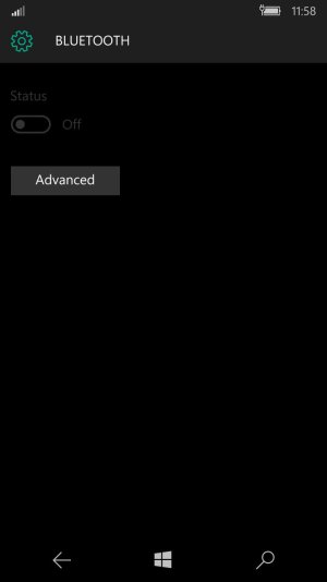

I have a new Lumia 950 with latest OS installed: 10.0.10586.420.
From the first minute I've used the device, I'm unable to use Bluetooth. In the Bluetooth menu, the Status = OFF and greyed out. So I'm not able to switch Bluetooth ON.
After 2 - 3 -... soft resets, it suddenly works again. But only for some hours.
I've already done 2 hard resets, same story. It works for a very short time.
Can someone advise me what to do?

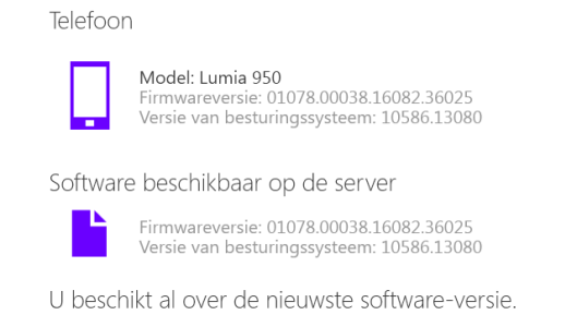

Fresh installation including firmware update, but still the same problem.
