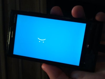

I went to update my Lumia 920 to 8.1 Preview, but a family member (the grandpa), decided to flip the light switch, thus turning off the outlet that my Phone was hooked up to. I left to get dinner, got back, and it was frowning at me. I was greeted, not with 8.1 like I thought, but a blue screen and white sad face. It's stuck in a loop where it turns on, says "Nokia", goes to the blue screen/sad face, then restarts... Tried hard reset, tried using Nokia Software Recovery Tool, and Nokia Care Suite. Any fixes??2014-05-14 16.09.37.jpg2014-05-14 16.09.37.jpg

Did you get to fix it?
I had a similar problem and it was fixed using Nokia Care suite dead phone recovery mode.
If its still not fixed, let me know, I will guide you through it.

Just got this on my 520 after pulling battery after a freeze. Had to use Nokia Recovery. Fortunately, it installed WP8.1 and Cyan.
