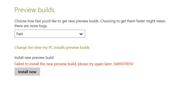

I have problems upgrading to the new build. At first I tried from PC Settings -> Update and recovery -> Preview Builds.
There it first downloads (takes forever), then starts the installation (takes even longer), before it gives me either error code 0x80070050 (the first two tries) or 0x8024001E (the third try)
Picture: failedtoinstall.PNG
I've tried rebooting, disconnecting usb-devices, restarting the windows update service (net stop wuauserv, and net start wuauserv, also tried renaming softwaredistributions to softwaredistributions.old in hope that it would re-download the whole shebang.)

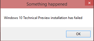

I've tried installing from the ISO twice, first time I just mounted it and ran the installation, second time I created a bootable USB and installed. Both times it installs (takes forever) and then give me this error just as it's about to restart:
Picture:
I haven't tried a clean install yet, can do that as a last resort, but would rather get this working without having to delete all files etc, so any tips or suggestions would be greatly appreciated! :smile:
