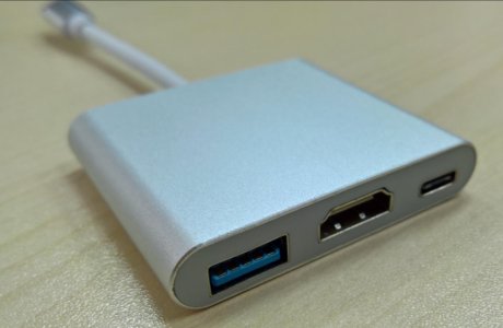

I have an issue with my Lumia 950 Dual Sim. I have bought a third-party adapter usb type c - HDMI and when I connected it to my external monitor - screen does not work at all or periodically showed the start screen for a while, but then it switched off and shows a message "no signal". I have the latest anniversary build 14393.693. Continuum app still detect my monitor. What can cause such an issue?

Actually, it does. Montior has it own power and continuum works more stable if I put my phone into flight mode. If I swith on WiFi - display sometimes crushes. Moreover it works both with external monitor and usb dongle to my wireless keyboard & mouse. Here is my adpater:
