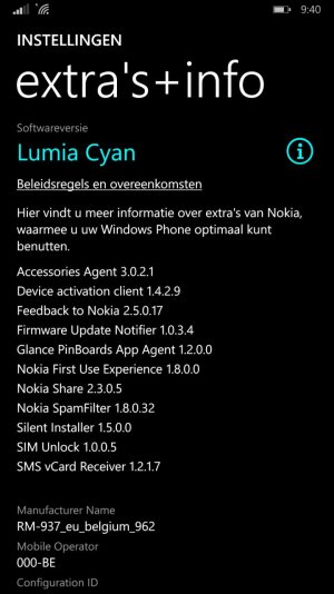

Yesterday I tried to update to Cyan OTA but the installation of the update stopped at 96% and gave me the following error: 80188309
Because I couldn't wait for Microsoft to fix it, today I tried using Nokia Recovery Tool and it worked.
Good luck.

I was on Dev Preview but this gets removed when using the Recovery Tool.
When Cyan is installed you can just re-enable Dev Preview and you'll get the latest updates again.
It is noteworthy though, that using the recovery tool is NOT an actual update. Update means, that you keep your data and whatnot. In case of the recovery tool you're flashing your device with the latest OS/firmware, hence losing everything that is not part of the OS backup (like app/game settings, save games/game progress)..

The update is released OTA and will be downloaded to the device but upon installing the update it wil stop at 96% and throw the following error: 80188309

Unchecking the checkbox in the app will not remove the already installed update(s).
You'll have to wait for the update to be released for people who have the Dev Preview installed.
