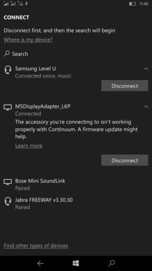

Hi Bretagne
I do get the same error message, now I have reported in Insider feedback (I could see few others have also reported same problem)
Firmware for my wires display adapter is upto date.
You have to download "Wireless Display Adapter" app from the store. In the menu there is a Firmware tab, go there and download latest firmware.. It will do the rest... I did this a month back when I check it now it gives a message that latest firmware is already installed. So I believe it's nothing to do with the adapter firmware rather something is broken in the latest build.
