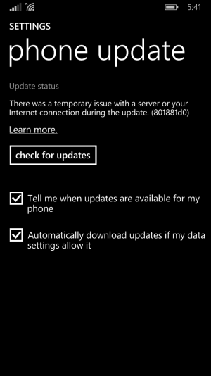

I have a new 830, which came NIB, in a AT&T box; It's a black frame model.
My point in getting this was to update it to W10. As I've done in the past, I've installed Insider, Fast, and when I go to 'Update', I get the (attached) error. I've tried updating this before ever inserting a (AT&T) SIM card (from existing 950), as well as with the SIM inserted.
Any idea what the deal is? It says downloading update, gets to about 63%, then throws the error. I've tried this a half dozen times, now. I can assure there is no issue with the "internet connection".
Thanks!

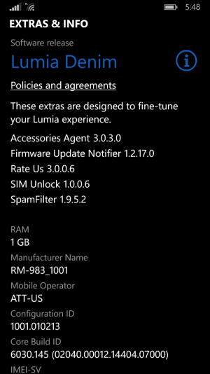

Update (per some found suggestions):
> Inserted SD card, same result
> Disabled WiFi (and update via cellular), get message "You must connect to wifi to download the update" (Data Sense is set to No Limit)
Running a network speed test, my wifi clocks-in at 115MB/s, so it's not a wifi/internet connectivity issue.
Dang! This is frustrating.
Update:
Maybe this is well-known, but I failed to search/find this as a solution. I ran Windows Device Recovery Tool (forgot I even had it installed), and it detected a newer version of software/firmware for the 830. After running the tool, it updated just fine. I then used the Update Advisor app to kick-start the W10 update process. A few restarts, and updates later, all works great. Maybe this (WDRT) is such a stupidly simple answer. I don't know. It worked for me!
