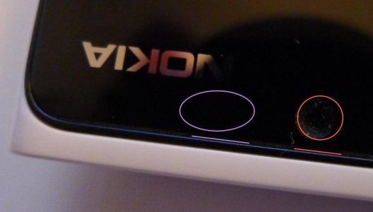

I had exactly the same problem and after a couple of month fighting with the dust I finally sent it in to get this fixed.. I bought mine at MediaMarkt Germany and they don't give you a replacement that easy, they want you to send the device in for reparation. Anyways, rather than giving my Lumia 920 to MediaMarkt I have requested the reparation through the NOKIA website.
I brought the parcel to the post office on Wed 2nd and they already fixed the phone by Fri 4th. My repaired Lumia 920 arrives tomorrow on Mon 7th and that really is an pretty decent time for a reparation.
I have called them to asked what they did:
+ Removing all dust
+ A couple of parts got replaced
I am really excited to get it back tomorrow and to see what parts they exchanged.. I hope they got rid of the little slits above front facing camera and approximation sensor so that no dust can come in anymore (see picture)
I gonna let you know about the repaired phone tomorrow!
