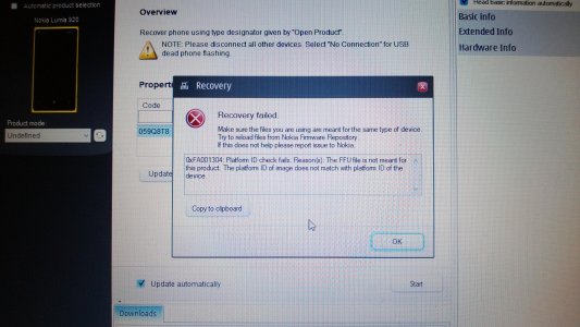

re: Flashing AT&T lumia 920, is it impossible? Cause I just can't so far....Can anyone help me?
WP_20130619_001[1].jpg This is the message showing on my system everytime i try to change my firmware. I tried everything, many different product code, now i'm trying to use a Brazilian unbranded...but...i just can't ...don't know why!!
tell me did u try this code (059Q6W4) firmware?

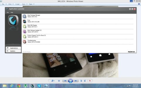

picture one this is my nokia care suite
do u have fuse installed?
select product support tool for store 5.0
did you download the firmware files RM820_059Q6W4
note : latest firmware for this code is 1314 ,,so you might hav to update your at&t to 1314 via phone ,,( i believe u knw what im talking)
