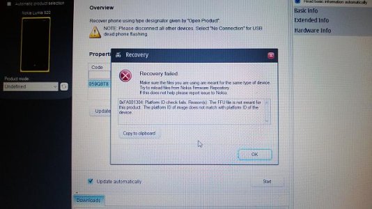

hi vimukthi i have read the whole thing that you are talking about but it still not work for me i got the same problem. can't flash to deference firmware. please help me out.
Nokia lumia 920 att RM-820 059L848
try to flash to 059Q6W4 or 059R14H6 it's keep getting error

i keep trying to flash it again and again but it's the same thing. Recovery Failed. make sure the files you are using are meant for the same type of device. help please!
