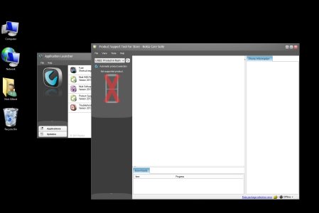

trying to flash my lumia 920 but when I connect my phone no phone information is being shown as in the image attached is this normal?

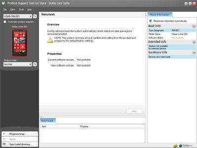

yes I have already downloaded the firmware, I am just abit confused as it wont display information about current firmware on the phone also when the phone is in flash mode I get a red cross saying phone is not supported is this normal, I have attached a screen shot thanks.
ok this one i never saw it on my NCS,,
but i see u have choose ur usb port,,
try to flash it as no connection
