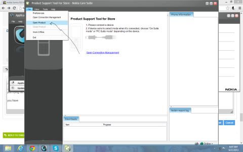

Flashing AT&T lumia 920, is it impossible? Cause I just can't so far....Can anyone help me?

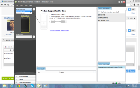

picture one this is my nokia care suite
do u have fuse installed?
select product support tool for store 5.0

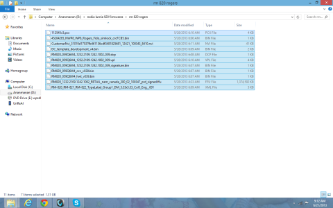

did you download the firmware files RM820_059Q6W4
note : latest firmware for this code is 1314 ,,so you might hav to update your at&t to 1314 via phone ,,( i believe u knw what im talking)

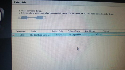

Yes, my friend, I know what you are talking about...mine..the product code is 059L848, firmware 1314, updated. You know what, i'm downloading the brazilian product code and then i'll try it again. But what i want is a firmware that i can choose between 3G and 4G. I've read some posts and i know that there is euro...version that i can choose de connection...you know what i mean...but first i want to flash for the first time... :(

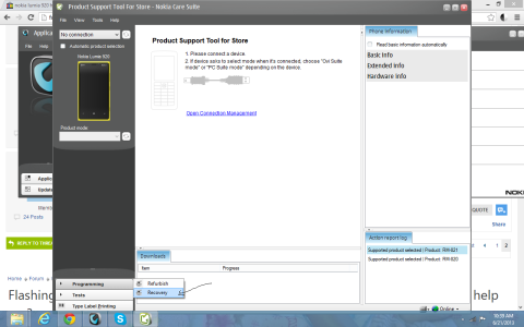

you trying recovery or refurbish,,

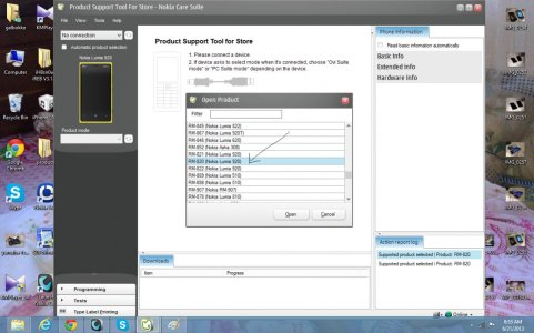

then select
now if you connect your phone its shows like this but u should select as no connection,,
so my question is so far did u try the same way im showing you?
so far its ok let phone connect to computer,,

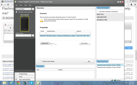

then select recovery

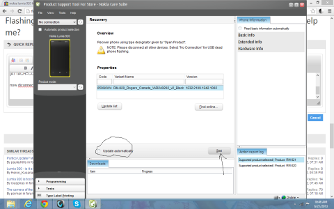

then when u click update list rogers firmware,,
i know u might knw these steps,,,im going step by step so we r not confuse
now diconnect the phone click start,,untick update automatic,,
now u will get this messages in few minutes ,,

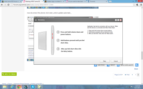

then you connet ur phone while its on,
while its connect it to computer turn off ur mobile but get ready it will turn on its self so as soon as u powerd off get ready to hold those buttons,,so whiles its turning on hold those button hit retry as soon as u feel the viba let go buttons,,if u do it correctly im pretty sure this will show ..

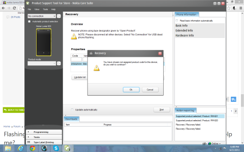

Yes, I tried just like this! You know I even reinstalled the windows system on my computer cause i thought it could be a problem with my computer, but it didn't work anyway. Now, when i try to flash NCS start showing that it is flashing for like 3 seconds, but then i have the same error as the first print here!!!
I'll try once more...but i did that! :(
