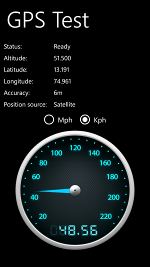

Just picked up satellite source while traveling in a bus. What I found out is that: Unless your speed is >20Kmph the GPS stays the same. I used Mobile Data for fetching current location.
