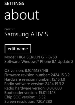

Succesfully updated my ATIV S to 8.1.2, partially using the instructions in this forum. I started from 8.10.14219.341 with firmware 2424.15.3.2, didn't do any flashing or hard reset, just installed the registry editor and changed to the advised settings. At first it didn't find any updates, then I found in the 'Tweaks' menu of the registry editor that the 'Preview for developer builds' was still on, after switching that off the phone updated to 8.10.15137.148! I put back the original registry settings so the Samsung apps will keep working, below the result (still shows HIGHSCREEN, but after registry editing it is SAMSUNG again).
