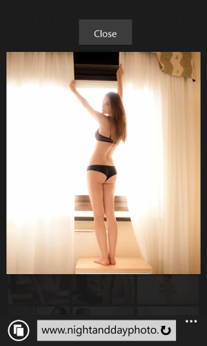

Thumbnails are very pixelated, but the photos themselves are not pixelated on my Lumia 1020 with 8.1, not to my eyes anyway:
thanks for posting the screenshot. You see, you are using the same phone and same OS version I am, yet it looks different for you than it does for me. That's why this is such a head scratcher! Reading all the responses, it looks like the results are pretty mixed. Having inconsistent results makes it extremely hard to troubleshoot. argh...
