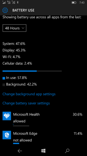

Is anybody having high background usage from the Health App over the past few weeks? I noticed my battery was draining faster than it used to and started keeping an eye on it and it seems to be getting worse. 30% over the past 48 hours, 40% over the past 24 hours.
Now I certainty haven't been keeping track or regularly checking the battery usage meter, but i don't recall ever seeing MS Health being at the top of the list. It's only been over the past 2 weeks or so. Can't recall if it started before or after the 10586.164 update or not. Firmware is 39005.
Is there anything i can try before i resort to a hard reset?
Thanks!

Interesting that your system and display show like 47% 45%
My Display always hover around 70% and my system is around 15-20%
I usually notice a 80/20 split between In use & Background as well.
I guess I'm actually looking at the phone a lot more than you?
Lol you must be. I'm not a high volume smartphone user by any means. Most days, I'm sitting in front of a computer 8-10 hours a day so no need to use the phone. I mainly use it to read articles during my commute. Rarely play games or watch videos.
I used to easily get a full day out of my phone and would still have 30-40% battery remaining when I go to charge it at night. Now, it's 50% in the early afternoon and I've barely used it.
I'll run with the reinstalled Health app for a couple days and see if it makes any difference. If not, I guess it's hard reset time unless anybody has other ideas on what to try.
