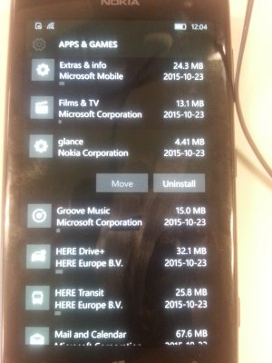

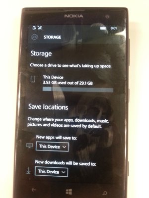

Does that xap you have posted in your guide install storage sense? Because this is what my storage app looks like right now:
Well. Tapatalk sucks and wont let me upload my image. But it seems to just be called storage on w10m. And there's no spot in there to uninstall anything.

Can add as an attachment.
Sent from my Ativ S
Re: Glance wont update (build 10572)
Nevermind. Found it. Thanks bud.
