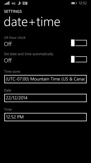

Hello,
When I set a reminder via Cortana, it never appears on time. I set one for 10:30 am this morning and it went off around 5:30pm.
Any ideas why?

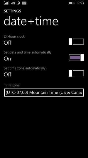

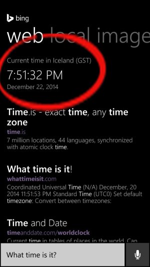

I ask Cortana what time it is and it shows Iceland (GST) - which is 7 hours off from where I am
I have date & time & time zone set to automatic. But switch it back just to show it is showing the correct time zone
So setting reminders via Cortana - the time is always wrong....
Help?
I tried setting it back to auto and restarting - no difference. Setting it to manual makes no difference either.
Thanks,
Mr.V

I think it's a red herring. It's not a Cortana issue but a Bing issue. Cortana uses your phone's time, but if you ask "What time is it", it'll do a Bing search.
I've just tried in IE (on the PC) the same search term in Bing, guess what? It shows my time as Beed, India not the UK.
So Bing is at fault, NOT Cortana!
G.
Hello gMasesterUK,
Thanks for that! I never realized that. I just tried it here on a desktop, and guess what - it shows: Current time in Iceland (GST)
Bizarre!!!!
So....how do we fix Bing.
Thanks for replying!!!!
I double checked my Bing settings, and checked that I had Location set correctly (which it was), and when it asked "what time is it" it now shows Bīr, Maharashtra, India (IST). So it's a Bing issue!
