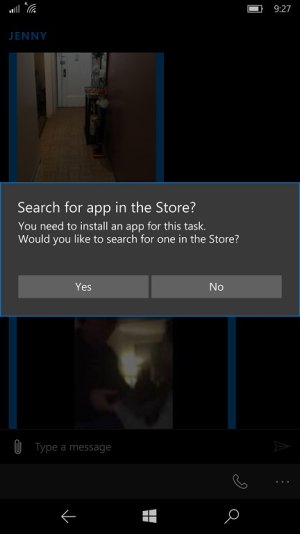

Received video text looks like a snapshot. I contacted HP support and they had me add a MMS APN setting
This changed the snapshot into a download prompt. When I press download it switched to downloading for about 2.5 minutes and then goes back to the download prompt. HP suggested I contact VZW Tier 2 support and if they couldn't assist me then I should contact Microsoft support.
I contacted VZW and they confirmed the MMS APN settings were correct, but they weren't sure why I added the setting since they said media content text should work on the device right out of the box. They advised my phone was provisioned correctly and MMS should work. I remove the MMS APN setting.
I contacted Microsoft support and they advised me they don't support third party hardware and i should contact HP. Microsoft support suggested I report it to their feedback hub.
I contacted HP support and informed them Microsoft advises that this issue is theirs.
HP is investigating.
Some of the video text message arrives as a snapshot with a play button> if I press and hold it it prompts me to save, open delete or forward. If I choose open I am prompter to search for an app in the store.
