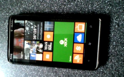

Thanks a lot for everything... This is a really good post... It was very easy to follow the steps.
I was wondering if anyone tried it. Thanks for the feedback. Glad you have 7.8 ��
I spent the whole night looking for a solution to this update... It was really helpful...

Your instructions worked perfectly for me (TMOUS HD7, formerly on Mango). Thanks, sinlessearth!
I just updated my HTC HD7 TMO US to Windows Phone 7.8 and successfully ported to my device using this exact same instructions. I figured out for 6 hours because at the first I just have 8107 version and need to update to 8112. Everything works well until it comes to 8773. I forgot to install the display language (my device use English 0409), and I need to roll back to 8112. I did the exact same thing for 4 times and successfully updated to 8858 without having any issues (wifi, about, and people hub). Sometimes it worth to try :D
