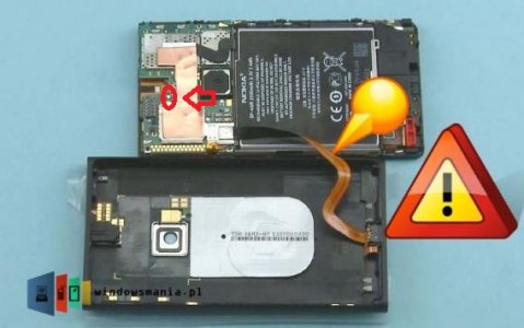

i have found something broke inside my nokia 920

something was making noise inside my 920, i have found one connector broken, that one in the picture, i don't know what is his purpose? my phone runs just fine!
thank you, and sorry for my english.
Hi. The broken connector is a contact for the qi wireless charging. If you don't use it don't worry. I think that connector can't be replaced because it's placed on the main board directly.
thank you, i thought it was the noise cancellation mic,or the head phone jack, i don't use wireless charging.
Sorry. I've made a mistake viewing the image from the phone. That's not the wireless charging contacts, because it is over the battery. Sorry but I don't know what that part is it or do.
headphones work! i have tested cancellation mic with a recorder app, sounds well, i still don't know what it could be and what problem i am having! :(
wifi is on all the time works, usb works tested now with my laptop, nfc never used, but tested, still works... so far so good, it's just one connector in a set of two, maybe other one does the job too, thank you for your answers.
Just send it to nearby nokia care. Or give it to me don't worry i take good care of it but not giving it back :p
Seriously go to nokia care. That phone is too good to broke :v
after watching the ifixit video, now i know it is one connector for the nfc antenna... so no real problem for me, interesting fact that it still works...
