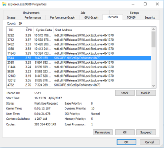

It's gotten even worse now on my Surface: whenever I bring back the system, even just from standby, various processes such as explorer, media player and internet explorer are driving the CPU up to 100%. Analyzing the threads with process monitor shows the problem is related to some function attempting to determine the DPI for my monitor.
My thinking is that update 726 may be required before you can install the new graphics drivers. This may explain why not everyone got them yet via Windows Update. I installed them manually. Or maybe, there's a problem with those new drivers and Microsoft has pulled them from WU for that reason.
In any case, I have rolled back to the previous driver and hopefully things will be back to "normal" now.

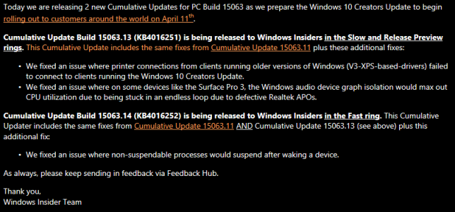

An update on this, it really is the Realtek driver. I reverted back to the standard MS driver and the issues were gone. I also used the hide/show tool to prevent it from updating to the Realtek driver again.
But today MS pushed out 15063.11 and the issue seems to have been fixed!!!!!!!
Will report soon :)
