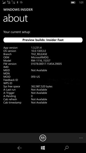

It won't show you on that screen. Here's how to test:
- Pick a ring, reboot phone.
- Re-open app
- Instead of re-picking a ring again, tap "..." and open settings
- Check the About screen
- It'll show you which ring the device is currently configured for.

Thanks for the instructions. I would have NEVER thought about checking configuration status in the about screen. Anyways, I'll give my phone a reset later if the issue hasn't been resolved.
Huh, TH2? (Threshold? :D)
Also I deleted some stuff. IDK which ones are safe to share haha.

Thank you! That rules out the app. It shows I'm in the fast ring.
