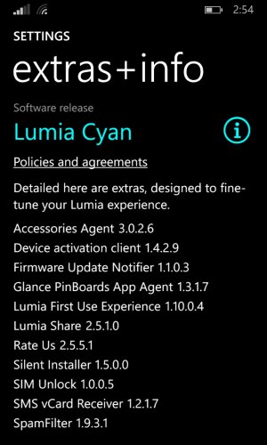

I am on T-Mobile, and just picked up an RM-877_nam_usa_957 from the Microsoft Store today. Internet sharing did not work at first. However, after updating to Cyan, I can confirm that internet sharing does work.
Also, in regards to your 2nd question, the phone definitely has LTE on T-Mobile. But that is just a side benefit to AT&T sharing the same LTE band (4) as T-Mobile... because the HSDPA 1700 band is still locked. This means you only get 3G or LTE everywhere. 4G is only in refarmed areas. The only way to get 4G in all areas is to unlock the HSDPA 1700 band. Canada has firmware that unlocks it so that it is pentaband (meaning: both 4G HSPA+ and LTE will work) but I'm not sure if it will flash or not. I'm attempting a little later tonight. But that's getting off topic :P The point is, Cyan seems to fix the T-Mobile "bug" with internet sharing.

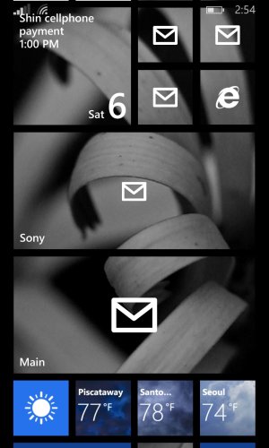

Can you post some screen shots of the home screen and apps that come loaded on the Microsoft Store version? I am surprised the 4G 1700 band doesn't work...Also, what is the default ringer and theme on the unbranded version?
I never saw the phone stock - I restored a backup from my 925... the only app that jumps out at me is "Lumia Beamer", but I may have downloaded it once and forgotten about it.
Default ringtone is 'Nokia Tune'
