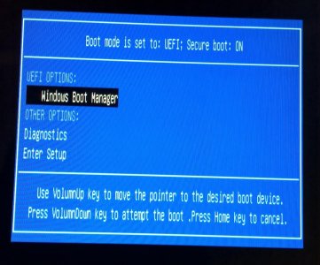

I had tried that too. Volume Down takes you to the BIOS, where you can't do a whole lot to remediate my problem (or can you?). Volume Up takes you to the boot manager, which looks like this. I can't find a way to fix anything else from here. When I run diagnostics, they all succeed (including Tablet Panel). Setup simply takes you to the BIOS.
Is there a way to reinstall WP81 from SD card or something like that that doesn't need to boot into WP10? That's when I lose the touch screen.

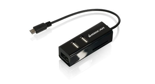

I've got an HP Stream 7. Last build caused issues , so I got an IOGear OTG dongle with 3 USB ports, as well as SD and microSD slots, so I could connect my keyboard, mouse and USB recovery. Definite must have when playing with tech preview. Put all of your drivers on the USB as well

So, unsure the cables I have that adapt mini USB to regular size USB were OTG (since I'm not sure whether that's some type of special cable), I purchased the one horseybob recommended and waited for it to arrive. It arrived today and, right away, I connected it to my Venue and a mouse to the cable. NOTHING. The mouse isn't even getting power from the Venue, since the light doesn't go on. Tried another mouse... same thing. Different USB port on the cable... nothing. The logon screen is there and I can't slide it up to type my password.
WHAT AM I DOING WRONG? I don't know what to do to save my tablet, which is perfectly fine and only needs W10 touch display drvers/calibration or a way to reinstall W81 without needing the touch screen (SD?). :(
