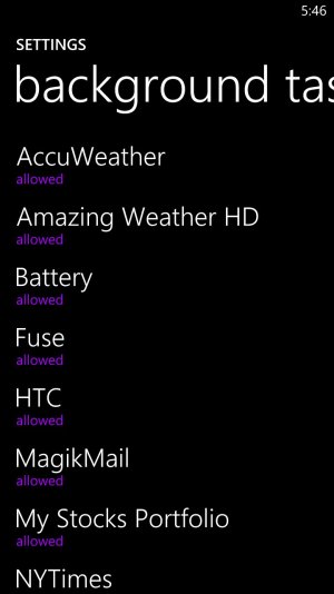

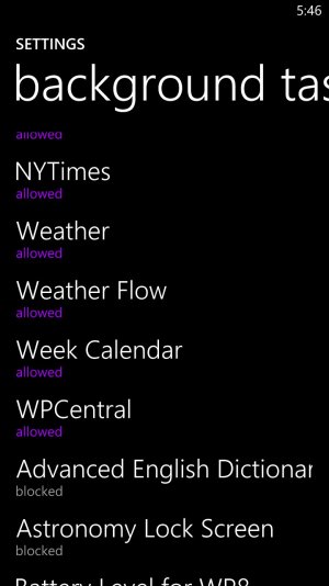

Please list what apps you have unblocked as background tasks.
Do you really use 4 weather apps? 5 if you count the HTC hub? Block some of those first.
Are there others in the list that you don't need to allow to run in the background? Tap each one, read the description of the background task and disable any you think you don't need.
Do that, soft reset and see how it goes. If there are some you disabled that you would like to use, enable them one by one and see how performance is.
Thanks for the suggestion, will try and see how it goes. Thing is I've always had all those weather apps, and most everything else on there, and the tiles were working fine until recently.
