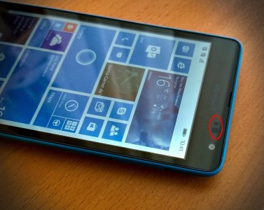

I've made a new picture of these visible sensors for another forum, so I'll share it here as well.
Sensors are circled and if you can see them, no need to boot the device or run Multitouchtest : you can be sure it's the new model of touchpanel :)

Thanks for this info. But my L535 Dual SIM Variant also has the same set of sensors (two circles beside the front facing camera), and I have not had my screen replaced. I got this phone in the first week of February in Asia, which means that the hardware could be a lot older.
It would be nice if we could see someone who can share with us a photo of his or her L535 screen that has a different set of sensors than what we have, since your "new" screen looks the same as my "default" screen. Nonetheless, I no longer have those touch issues after the 15114 firmware update.
Fortunately, I had captured my 535 before sending it back to the Care, in case of.
So this was my "first" touchpanel (the fade-greasy-buggy one lol)
It does appear that there are no sensors where they should be, but it could be that the opacity of the screen covering the sensors are now different for the new screen. I must note that I need to shine some light on my L535, or at least stay under a bright sky, to be able to see the sensors. The best comparison would be to have an "old screen" and a "new screen" taken side-by-side under the same lighting conditions.
Nonetheless, if there was such a change in opacity for the sensors, then the screen indeed must have been changed.:cool:
