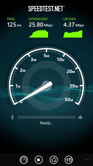

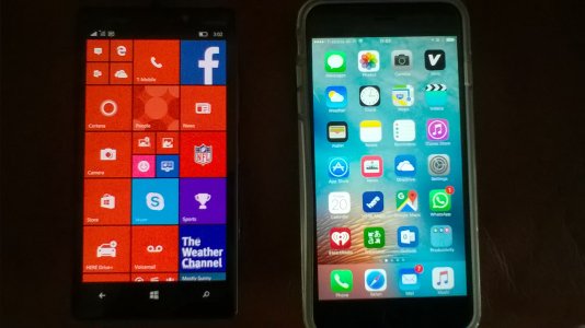

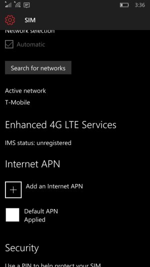

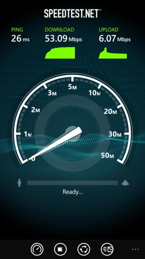

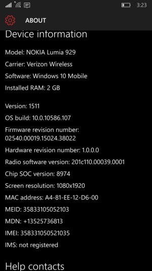

I have enclosed some pictures so you can see that Windows 10 work on a Lumia Icon Phone running on T Mobile LTE, see speed test on four bar signal, WiFi turned off and Speed test on Bright House WiFi, one picture (poor) compares my T mobile Iphone 6S plus signal with the Lumia Icon signal both 4 bars /dots.
