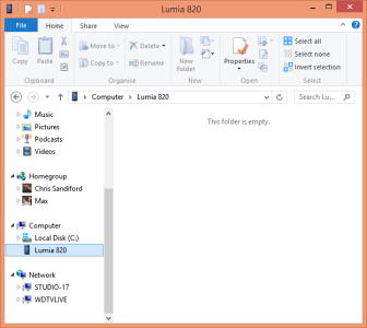

Sorry to bump an old thread but this is happening to me now (screenshot attached)
Phone detected, icon appearing but no SD and Memory folders.
This is the first time it has happened in a couple of months but ironically, also it's the first time I'm using the cable that actually came with the phone - I was using one from a L800 before, not that it should matter
I have 4 x USB ports on my laptop and I have tried all four and still the same result.
Weird.

Solved this problem.
Corrupted files on my memory card was the problem. Removed everything, reformatted and all fine. This was also stopping
me sharing photos on Facebook, weirdly.

The corrupted files were all in my Music folder and were easy to spot because there were hundreds of folders with titles such as ?%&?!!! etc. in random top level artist folders which were uncorrupted.
As it was only music (which I had copies of anyway) I just reformatted the card from the phone and reinstalled everything.
I narrowed it down by deleting folders and the ones containing corruption wouldn't delete.
Once reformatted all was viewable again in Explorer.
Its all down to syncing and copying via the USB cable which gives the music duplication error too. I don't trust the cable for anything except PC charging now. If I want to sync/copy music I remove the card and put it in an SD adapter. Its a ball ache but until MS fix it, its the only way.
