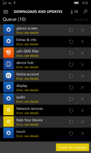

It had no trouble installing and updating most apps. However, the 'system' apps, i.e., those in the settings you find under Extras, or device specific, will not update.
Attached is a screenshot, showing which apps do not update.
The error code I get for the download trouble is 0x0x803F7000, which is no help when searching the internet!
I am guessing this is because I am on the ATT version, and so I do not have the denim update? Can anybody confirm this, or know how to fix the issue?

My 1520 with denim and on at&t had the same issue. I could not update glance screen as well as one other.
What I had to do was fresh install, no restore from a backup. I then updated the phone with all updates possible while in windows 8.1 mobile.
I then installed the windows insider app and checked for app updates again.
Then, finally updated to 10581. I did have a few of the system apps pop up again after upgrade and I thought I would have the same problems, but they installed properly.
I don't remember denim being a prerequisite for the upgrade, but it may be so.
