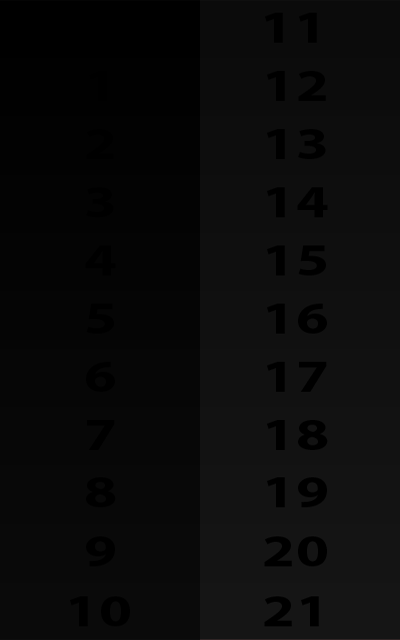

Lumia 950 huge screen calibration problem. Please test and post results.
I checked right now the trailer on both at 0:17, red tint on 950 and green tint on the XL, the scene on the XL is very smooth on near blacks as it should be, on the 950 I can clearly see the stains, there's a lot of difference between "grey 6-5-4-3-2-1" to "black 0" and those greys are like the same between them, making the stains. Also I can see more of the dark side on the 950 due to that equal greys, on the XL those zones are black like "greys 4-3-2-1" being "black 0" in comparison.

What test image?
Test image being the one with the numebered boxes. But from your explanations I understand you took the image too.
The results are interesting.
Basically the XL is ok (except the tint - have you checked if both have the same color profiles?) but both have problems with the drivers...

I can't see the attachment of the numbered boxes test image within the thread, can you repost it?
@Mindtaker - if does not jump between black to very light gray in one step then it is good.
This is actually the problem: jumping from one very dark shade to a totally bright grey... and on some levels of brightness we get a brown/red box between them. it is horror... :(
On Lumia 950 the box no 3 is brown/red and it is the most different. It has nothing to do with a grey gradient transition. Therefor I think it is the principal generator of the unpleasant effect in the dark scenes movies/frames.

Mmmm interesting, if I move the green/purple slider in color profile on the 950 all the way towards green or red, the color of the box n?4 f*cks up and gets weird but if you calibrate it gets perfectly grey.
The same thing does nothing on the XL, in fact I can't fix the green tint on greys...
Can you provide a screenshot of the combination that provided a very good grey? I only get either green or purple or very bright gray on that 4 box
Well to a good screen yes, 0-3 are seen as black, although in reality only 0 is pute black. The eye simply cannot see a difference. I mean on any other display I cannot see the number within (all numbers are pure black) the first 6 cells.
