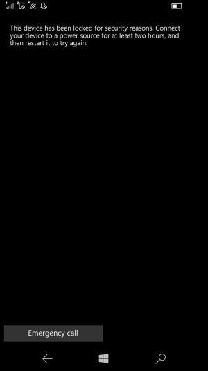

wp_ss_20161016_0001.jpgI have had this phone since its launch with no issues, but lately its being rebooted every hour easily. Last night I got this message that phone is locked due to security reason. Plug it for more than 2 hours and then restart to use. I have attached an image. Can any one help me out here, how can I avoid this rebooting? I am using the Windows 10 Mobile Production version 10.0.14393.321.
try doing a factory restore that will clear it up, maybe someone more knowledgeable can help maybe with an easier way of fixing that?
Hi, i already did factory reset twice now, still seeing the same issue, Is there a way to change the firmware? I used Device recovery tool twice but still once i start the phone after reset, same thing restarts for no reason. Whether am connected to wifi or not, it restarts :(

Hi Rohit, sadly I do not stay in India, I got the new battery but I still see the same issue :( the phone reboots and battery becomes less at an alarming rate.
I went to Microsoft store but they are out of any phones/batteries for 950xl. I don't know how to fix this. The previous firmware did not cause this issue, is there a way to roll back the firmware? I already tried wdrt but no effect at all.
Before replacing battery try to clean its connectors with a soft cloth that is sprayed with a little alcohol. Also do same to two pins on the back of 950XL as well as two plates on the back cover where those pins connect to back door. Also after back cover is inserted in place push softly on back cover so the two pins connect properly to back cover. Do not scratch tips of the two pins as their connection to back door is vital for 950XL proper functioning.
Hi Mesbah/Rohitdas i tried your suggestions but still the phone is doing the same thing. With the new battery it reboots more :(. I suspect this has to be because of some firmware thing. I remember this don't happen before, once the last firmware came it started :(. Do you guys have any other solutions? This was my primary phone and its difficult to operate like this.
I already tried that ,last i heard there is no lumia 950XL stock anymore since they stopped manufacturing, MS store guys told me to talk to MS support and nothing else :(
