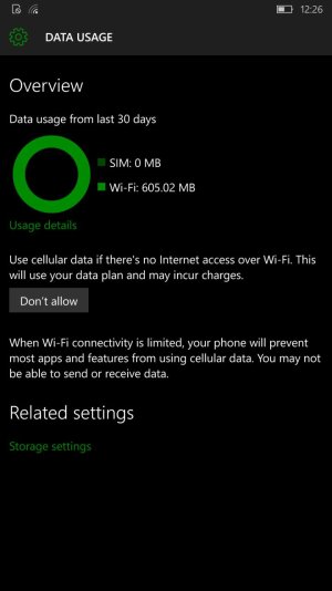

You can check if the following options are setup correctly on your phone.
1) Check if you are automatically using Mobile Data when you don't have wifi. If yes, click the "Don't Allow" button.

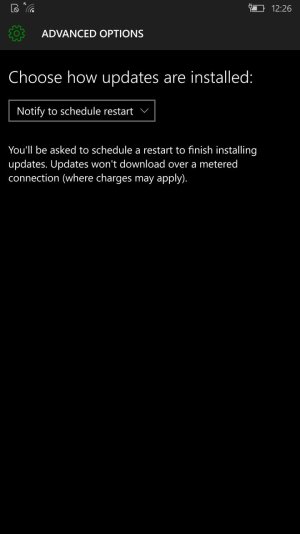

2) Check the phone updates page. It must show the message in the screenshot below. "Updates will not be downloaded over a metered connection".
The next setting is from the store when you have to setup "not to use metered connection" for app updates. With all these settings, the OS should not use data.
