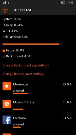

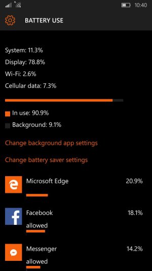

I can confirm the same for messenger. Here is the proof before and after:
Until they fix this problem, skype should be off in the messenger settings...
From your screenshot we can find out the following :
1) Most of the battery drain is when you use (in Use : 96.0%) the phone and not in background (Background : 4.0%)
2) Messenger shows usage of 27.9% battery, but it is FACEBOOK MESSENGER.
3) Display has been taking up 83.4% of your battery usage as you were using your phone very frequently.
Ohh. You are right. I did a rookie mistake again, and mixed up messenger and messaging apps :| My bad...
