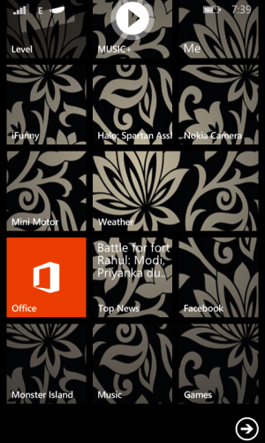

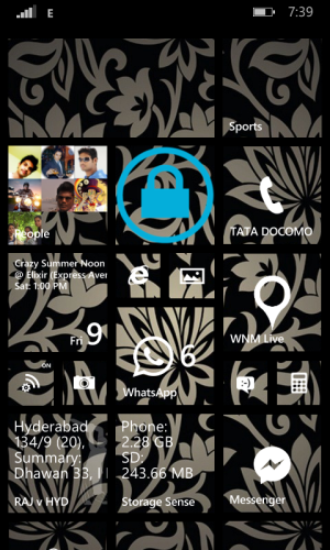

it happens such everytime i go back to my homescreen. Some times at the lockscreen after typing in my password the phone takes around 1minute to open the start screen. I have tried hard reset multiple times but still no change .

Hard Reset without restoring your backup. It helps removing all the lag. Take screenshots of your start screen if you want to preserve it. Take note of what apps you have installed. After reset, go to store>my apps>select the apps you want to reinstall and tap download and sit back and relax as you get a brand new, fast and lag free phone.
Also, try removing the Cortana tile to see if it helps.
It is normal behaviour, dnt wry... After cyan update the is will perform much better.... I also faced this issue many times... Hard reset didn't help so I used too of this issue...
Mine is working fully and buttery smooth after I reset and DID NOT RESTORE BACKUP! This is not the normal behavior and can be fixed. Also my battery improved from 12 hours to 18 hours.
A CLEAN INSTALL IS ALWAYS RECOMMENDED!
Follow what I told you.
in my 720, every time I come out of a game, start menu icons go blank.. will try reset and get back to you..
btw that's one ugly start screen :D :evil:
