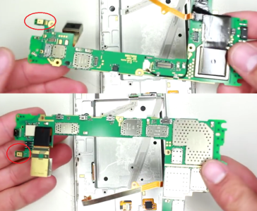

You should replace two top smd mics - they are soldered to motherboard
[video]youtube.com/watch?v=_ehIFioJx5w[/url]
Thanks. Already learned the hard way :(. And messed up a connector on end yellow ribbon cable at 5.44 on this video, anyone know what its for. just could not reconnect it no matter how much I tried. Phone still works fine with exception of the noise cancelling/speakerphone mics.

My Nokia Lumia 930 could record video without voice (neither horizontally or vertically). When I was making a call with speaker, the other side wasn't listening my voice.
A week ago I sent to service provider for repair. I was thinking only the mic (or mics) will be replaced easily.
Today I got it back from the service provider. I was told the whole board should be replaced. It cost too much the repair.
According to the pictures the mics are soldered on the board. Why the Nokia service provider couldn't replace the mics?

Looks like speaker, screw, gasket and mic. Looks like they kept the board and soldered the mic.
