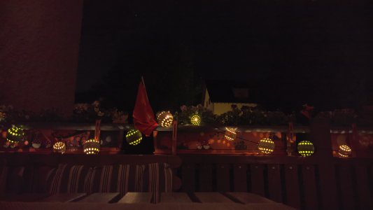

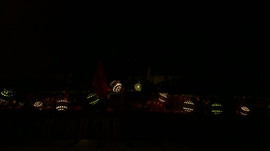

Here are the pics to show you what I mean. I did shoot the scene on the 1020 too for comparison. Focus point for all pictures is the small green lattern in the middle of the pic.
The Lumia 950 XL was set to manual mode for this. ISO was set to 50 on both pics.
Exposure time on the first picture was 4s and 1s on the second.
The purple/pink hue is clearly visible on the wall on the left side of the picture.

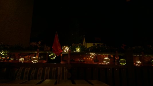

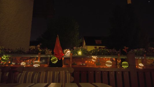

And here are the Lumia 1020 pics for comparison. I know that the second picture is to dark, but it clearly shows how the picture just gets darker with shorter exposure. The 1020 was set to manual too, ISO was 100. Exposure was again 4s for the first pic and 1s for the second. These are 5mpx oversampled pictures as windowscentral wouldn't let me upload the full resolution pictures (probably due to the large size...)

Nothing wrong with your phone nor software. What you are seeing is just different implementation of auto white balancing. There's no right or wrong on this. Different cameras give you different amount of color correction when you have a predominantly dark and reddish scene like that. Some like reds in tact, some prefer it completely removed.

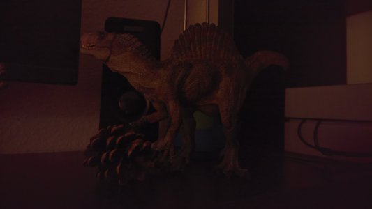

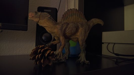

Here are two more pictures with a different scene. Both ISO 50, exposure on the first was 1s and on the second 1/10s.
