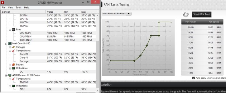

Hah, I installed both of those, gave them a go, and the ASRock one locked up my computer. The CPUID one had some odd readings, stopped noticing my CPU fan altogether after I started the ASRock one, and topped out my CPU fan's speed at 1601 RPM, all while idling on the browser with a few things running in the background. The ASRock one showed something just south of 1600 RPM and a CPU temp in the low-30s Celsius, I think.
What do you mean it locked up your PC? Not responding?
This thing is ****ed up! Now it works just fine. Those "now it suddenly works for no apparent reason" is making me losing it! FU ASRock, next time I need a new mobo I'll stick with Asus, MSI and Gigabyte.
My computer completely stopped responding to anything, did it a second time upon trying to use the ASRock software as well, so I'm just going to get rid of it. IT didn't crash or anything, it just froze and didn't accept any input. It's nothing I'm bothered by because I don't want or need the software. I'm still fine with the board I chose (minus the part where I broke off a pin from one of my USB 3.0 headers, but I have two, so I'm still OK on that front).
By the way, what is your current setup? I've got a 4670K running in the Power User mode (or whatever the one that is the setting that stops power-saving settings). CPUID is shoing my CPU at 28 Celsius with a fan speed of just under 1,600 RPM.
Do you mean the 3 presets? (Performance, Standard, Power-Saving). Standard. Performance should not work for me because the "Autotuning" button that appears in the bottom right corner is greyed out. Not much of a use anyway, since I have an i3-4130 and H87 mobo.....not OC-friendly.
CPUID shows now 25?C and 900-930RPM on the CPU and fan (but my window is open, so the temps are usually <30?C when idle during that time of the year).
I don't know....the CPU temp was rising slowly but constantly while I was in the UEFI a few min ago.. From 34?C to 41?C in ~2min in 0.5?C steps. No idea why and it would've kept increasing.
Edit: I happen to have the same issue right now, where I don't get any readings on the CPU fan speed (gone in CPUID and 0RPM in A-Tuning).
Mine actually did something different. The CPUID started showing 0 on the CPU fan RPM, then when I restarted the program (after a computer restart because A Tuning locked it up), it stopped showing the CPU fan on the list altogether. My i5 is consistently sitting in the high-20s or the low-30s in temp with a high-1500s-to-low-1600s in fan RPM.

Actually that's exactly how mine behaved too but now it just shows up and disappears randomly.

Could be that some ASRock boards don't have the best fan control to begin with (found quite a few threads with complaints about different issues) and that those two programs (A-Tuning & HWMonitor) are buggy.

Really, ASRock? Really? I need to set a custom profile for the fans in the UEFI to make them change the speed according to the temperature?
Because setting them to the existing profiles (Silent, Standard, Performance) makes them run at either the lowest (Silent; ~1000rpm) or at ~60% (Standard & Performance; ~1600rpm).
The BIOS version is up to date, same goes for ASRock's A-Tuning software. So I must assume that either their quality control needs to be improved or that they half-*** some of their boards.
