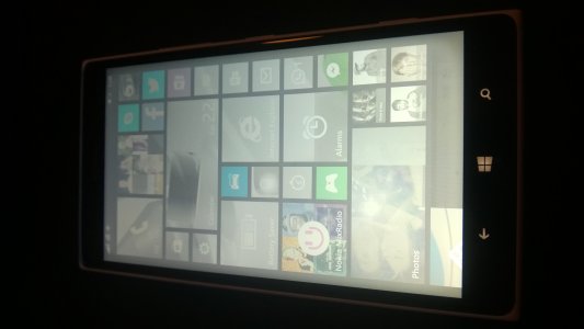

Hello,
I've got the following problem and am wandering if anyone has had a similar problem and if there is any way to cure it? I've done a search and can't find anything.
I bought my 1520 a couple of weeks ago. It was perfect till last night when the colours went off like in the pictures below. I reset the phone and it was fine till until they went again 5 minutes later (I was browsing the internet at the time) and I can't recover the phone.
Everything has 'greyed out' and stuff is randomly being burnt into the black/white background. If there is something loaded in front of the background there is no screen burn, and when you reset the phone, the background also resets.
I've got the 1520 and never experienced that short of thing!

Thanks for the response!
The phones on 8.1 yes. I also bought it from a private seller on eBay (was new) so between those two, not sure I have any warranty.
I find the colours invert sometimes, but only stay like this for a couple of seconds and then revert to normal.
Will try the hard reset now (I hate doing these - takes so long to reconfigure! :) )

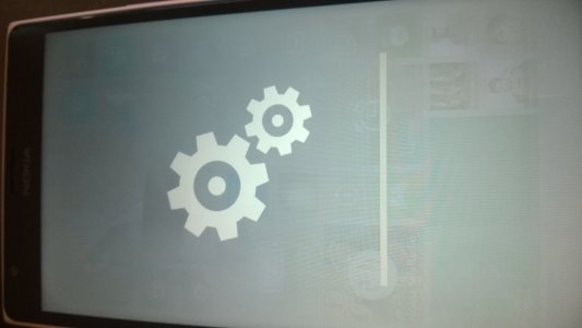

Well the hard reset hasn't helped:
I'll give Nokia a call tomorrow. Even if I can get something back from the seller I don't think it would be morally correct, so won't. It worked fine for 2 weeks, so unlikely they would have experienced it before.
