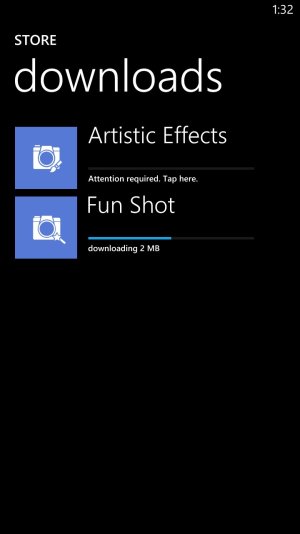

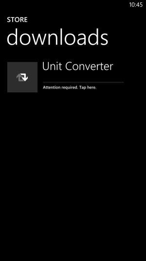

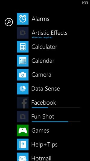

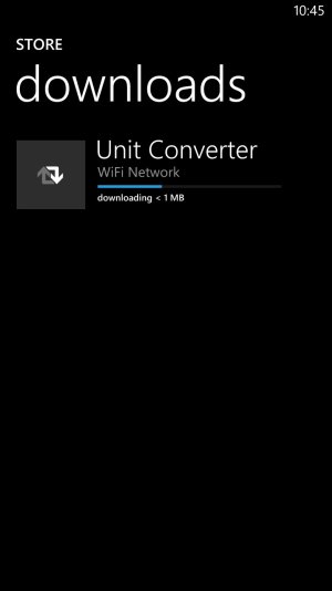

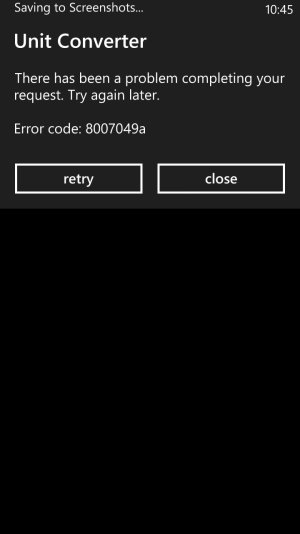

I installed GDR3 update on my Samsung Ativ S, the installing process went very smooth and i did a rest to insure that every thing is fine. Unfortunately, since finished, i cant download any app from the store, even if the downloading process went fine it stop installing the app and i got the following message:
Attention required> Tap Here > There has been a problem completing your request. Try again later. Error code: 8007049a
i tried with different wifi connections and the result is the same.
Now i stuck with the system apps and cant download any apps from the store, even Samsung own apps
When i search for the error code, all results confirm reset but i did that twice and nothing happened
Any Suggestions??? :unhappysweat:

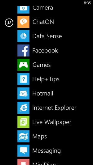

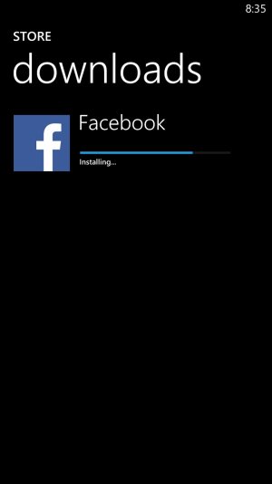

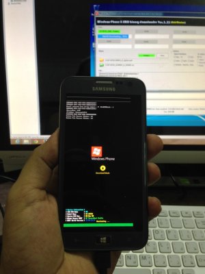

I solved the problem by (Flashing) the previous version of Windows OS Ver. 8.0.10327.77 following the flashing guide here: Samsung ATIV S I8750 Rom flashing! - xda-developers
Now every thing is OK and i have no issues downloading apps from the store
here are some photos from the process and captures from my mobile

Every single error is related to the error 8007049a!!! What is that!! I had never a problem with my phone before the update

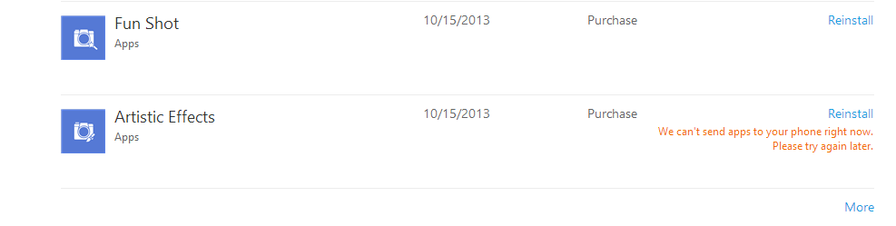

I also tried to re install apps using my pc store web site but getting the following message: We can't send apps to your phone right now. Please try again later

I noticed that the apps downloaded just fine, then during the process of installing it just run to the error mentioned earlier
