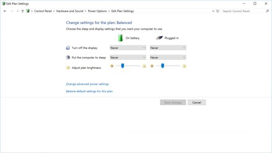

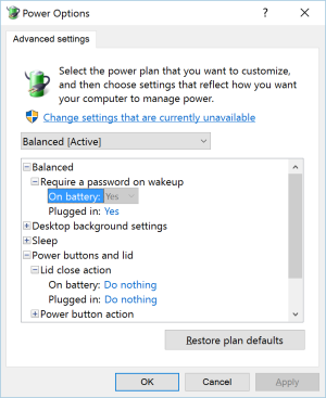

my surface book never sleeps. I force the system to keep running even when the lid is closed. every time I open the lid the screen shows what it showed before the lid was closed last time. it will not reboot automatically after system update as I set it to reboot manually under the control of mine.

I followed the advice of peter leung and set the Display and Sleep option to NEVER. I was away for a number of hours and the computer display was off and appeared to be in sleep mode when I returned. When I moved the mouse, it went straight to the windows sign-on screen. I logged in and was back exactly where I left off. There is something funky with the power options configuration. The computer does not go into sleep mode when the option is enabled. It appears to work correctly when set to NEVER. I will try again in the morning.

yes the screen will go off after some idle time. the screen will go off when the lid is closed too. but the system is running. when you open the lid, it prompt you to log in. after logging in, you see what you last seen in the screen. as an insider i always have to download updates overnight. usually i initiate the update process and close the lid and see the result next morning. i don't want the system to go asleep which makes update process interrupted.
