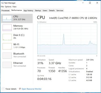

I notice that when i plug my Surface Dock into my SB that it spikes up to about 31% CPU usage and stays there forever. Even when it is not charging. It's making the fan run and my Book incredibly hot. This should not be happening. I dont remember it happening with the RS1 builds but i dont know if i was paying close enough attention. No wonder the dock has such bad reviews. WTF is this ****? When I open the task manager all of the usage is under "system and compressed memory" So that's it, nothing i can do about that. When i restart it does the same thing but if i unplug the dock the memory drops down to 0-1% usage...WHERE IT SHOULD BE WHEN THE COMPUTER IS IDLE :(

Well i can say almost difinitvely that it is NOT the dock. I plugged in my Book at work today (completely different space) with the regular charger that came with the device. It did the exact same thing. When it was charging the Book got up to 30% CPU or higher and leveled off the whole time it was charging. When i took it off charge it went down to normal levels (0-1%)
So my question now becomes, is this normal? I don't remember seeing this (maybe i didnt notice) when i was on RS1 builds when the device was charging. For anyone who has a Surface Book can you tell me what your CPU usage is when the device is on charge? Again mine spikes up, the fan runs, the whole time it is connected to power.

can you check which processes are running when the processor starts pushing 30%? I'm thinking it's a process that only starts when the device is charging, like an antivirus scan
I mentioned it earlier bud, it's System and Compressed Memory. It does not stop even when the device is fully charged. I'm really not feeling it for multiple reasons. For one it's eating up CPU usage that other processes may need to run if i am using the computer thus making it slower. Also the fan is making noise and it heats up like crazy, sometimes it gets so hot that i feel like i should just shut it down and charge it with the power off.
